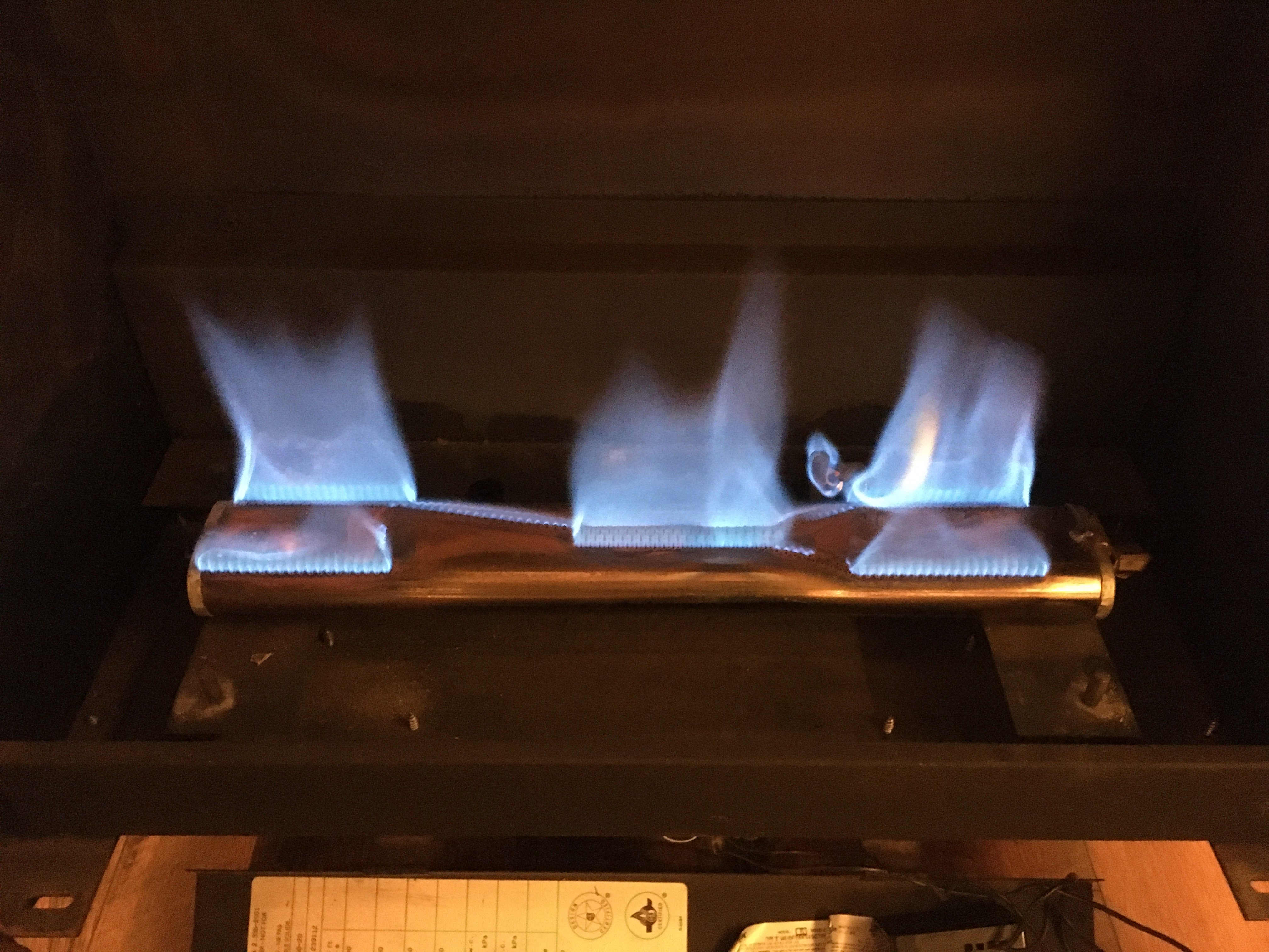

John Dirks Jr Posted October 18, 2019 Author Report Share Posted October 18, 2019 Here is the flame on the stove after being converted from LPG to NG. This is the lowest setting and it’s still too hot in my opinion. The instructions for the conversion kit mention adjusting the air shutter but this unit has no such adjustment capability, at least not the way the instructions describe. Also the manual for this model fireplace says the flame should be more orange, and not blue. If this burner has no air shutter adjustment , how do I make the flame more orange? Incidentally, I think an orange flame will be cooler. If they gave me an orifice that is too large, could that make the flame blue? What about my gas line pressure, could that be the problem? Do you have any suggestions which might help me adjust this flame to a more orange color like the manual says it should be? I want to make it look more natural, and hopefully cool it down just a little. thanks Quote Link to comment Share on other sites More sharing options...
Jim Katen Posted October 18, 2019 Report Share Posted October 18, 2019 That looks like a nicely balanced gas flame. Perhaps when you put the ceramic logs in place, the flames will cool as they impinge on the ceramic? 1 Quote Link to comment Share on other sites More sharing options...
John Dirks Jr Posted October 18, 2019 Author Report Share Posted October 18, 2019 Yes it does look nice for maximum combustion and efficiency. But the ambiance is lacking and it gets hotter than it should, even on the low setting. When the logs are on, the shape of the flames change but they still stay blue, with a tiny tip of orange. Quote Link to comment Share on other sites More sharing options...
John Dirks Jr Posted October 18, 2019 Author Report Share Posted October 18, 2019 The draft hood is 6” from the gypsum wallboard which is more than compliant with clearance to combustibles listed for this unit. Even then, the wall temp gets to 160 degrees. That’s borderline right? Quote Link to comment Share on other sites More sharing options...
John Dirks Jr Posted October 18, 2019 Author Report Share Posted October 18, 2019 Top of the draft hood where the vent pipe connects is in the 350 degree range. Quote Link to comment Share on other sites More sharing options...
Marc Posted October 18, 2019 Report Share Posted October 18, 2019 Reduce the gas pressure maybe? It's how I control the heat when I'm boiling crawfish on an outside burner. Quote Link to comment Share on other sites More sharing options...
John Kogel Posted October 18, 2019 Report Share Posted October 18, 2019 Hello John. Maybe you need less gas pressure with more air to get the yellow flame. Quote Link to comment Share on other sites More sharing options...
John Dirks Jr Posted October 18, 2019 Author Report Share Posted October 18, 2019 Whats the effect differences between changing the gas pressure and actual volume being delivered to the burner? I assume a smaller orifice would not reduce pressure, but it would reduce volume. Am I right? About the valve under the stove that raises and lowers the flame. Is it changing pressure or volume to accomplish this? Quote Link to comment Share on other sites More sharing options...
Marc Posted October 18, 2019 Report Share Posted October 18, 2019 (edited) The orifice influences air/fuel ratio. The pressure influences the size of the fire. Edited October 18, 2019 by Marc Quote Link to comment Share on other sites More sharing options...
John Dirks Jr Posted October 19, 2019 Author Report Share Posted October 19, 2019 Do you think if I reduce the orifice size the flame will move toward the orange color? I see no installed method for increasing or decreasing air to the burner. It’s manufactured without adjustable air shutter. Quote Link to comment Share on other sites More sharing options...

John Dirks Jr Posted November 8, 2019 Author Report Share Posted November 8, 2019 On 10/18/2019 at 11:28 PM, Jim Katen said: I don't know much about fluid dynamics, but it seems to me that you want to have a way to "dial in" the flame, not make incremental changes. I'd look at installing a needle valve upstream of the burner. Hi Jim. This needle valve idea you speak of, I might be giving this a try. I really think the problem can be solved by cooling the flame. It’s almost entirely blue now which I know is an efficient burn, and something you would want in a heat exchanger of a furnace. But in a free standing fireplace which is intended to be ornamental for visual pleasure, the flame should not be fully blue like it is. As a matter of fact, the operators manual even states such. It shows a graphic showing “blue flame, incorrect ”. “Yellow flame, correct”. So, will installation of a needle valve allow me to make the flame yellow, and thus cool it down? I mean, that’s solving multiple problems. Cools it down to prevent triggering the high limit from cutting it off and making the flame more yellow for more aesthetic appeal. Where exactly within the gas delivery lines would I install such needle valve? Quote Link to comment Share on other sites More sharing options...
Chad Fabry Posted November 8, 2019 Report Share Posted November 8, 2019 To make the flame yellow, you have to have incomplete combustion which means a fuel-rich mixture. 1 Quote Link to comment Share on other sites More sharing options...
John Dirks Jr Posted November 8, 2019 Author Report Share Posted November 8, 2019 1 hour ago, Chad Fabry said: To make the flame yellow, you have to have incomplete combustion which means a fuel-rich mixture. Ok. If there were an air shutter on this burner, I close it to reduce air and make the mixture richer. Correct? There is no air shutter on this burner. I suppose I can try and fabricate an air shutter of sorts to limit air into the end of the burner. Quote Link to comment Share on other sites More sharing options...
John Dirks Jr Posted November 9, 2019 Author Report Share Posted November 9, 2019 Actually this flame looks ok I think. It gets more yellow to it after it’s going for a while. By checking with my FLIR thermal cam I can tell the temp at the face of the ECO limit switch. I checked and waited nearby until the stove cut of. Take temp at switch and it’s 190 degrees. I think this is supposed to be 350 degree limit switch by the numbers on it. So it shouldn’t cut out at 190 right? I’m gonna order a new one and see what happens. Quote Link to comment Share on other sites More sharing options...
John Dirks Jr Posted November 9, 2019 Author Report Share Posted November 9, 2019 Apparently it’s not the ECO switch cutting the gas valve. It’s the thermopile. mv output too low. I got on this trail after trying to lite the pilot this last time around. I couldn’t keep it lit. Checked thermopile voltage and it’s at least 150 mv low. Quote Link to comment Share on other sites More sharing options...
John Dirks Jr Posted November 11, 2019 Author Report Share Posted November 11, 2019 I got a thermopile for $10 on amazon and put it in. The mv output was better than my original part but I still could not get the pilot to stay on. More troubleshooting and I discovered the wire connector for the vent safety switch connection at the back of the gas valve was bad. Some soldering and a new shrink wrap and we're in business. Quote Link to comment Share on other sites More sharing options...
