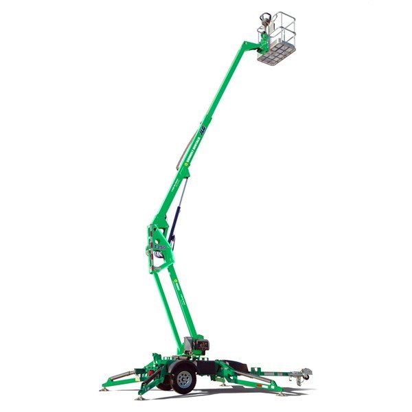

Les Posted July 22, 2020 Report Share Posted July 22, 2020 I am 75. My man brings this to the site for me with his pick-up truck. 1 Quote Link to comment Share on other sites More sharing options...

Jim Baird Posted July 24, 2020 Report Share Posted July 24, 2020 On 7/22/2020 at 7:31 AM, Les said: I am 75. My man brings this to the site for me with his pick-up truck. My tree guy used one of those last year. His reached 60 feet. 1 Quote Link to comment Share on other sites More sharing options...

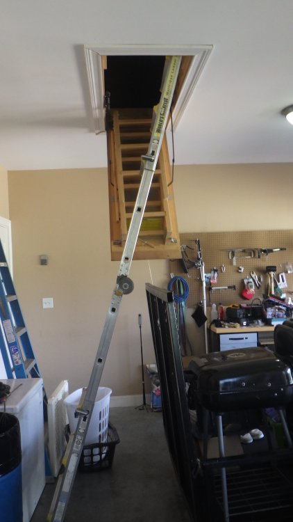

Jim Katen Posted September 3, 2020 Report Share Posted September 3, 2020 OK, Aaron. Here's the ladder for you: Quote Link to comment Share on other sites More sharing options...
