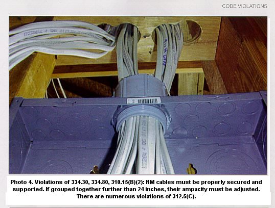

Joe Tedesco Posted January 8, 2008 Report Share Posted January 8, 2008 Is this a common practice in your area? Image Insert: 49.16 KB Link to comment Share on other sites More sharing options...

kurt Posted January 8, 2008 Report Share Posted January 8, 2008 What the heck is it? Like Eric said, we're all EMT & AC/Greenfield around here. I've never seen anything like that. Not sure I'd want to. Is it OK to bring in the entire bundle of NMC through that knockout/bushing entrance on the top of the panel? (I honestly don't have a clue how to install rope; someone toss me a bone.) Link to comment Share on other sites More sharing options...
Bob White Posted January 8, 2008 Report Share Posted January 8, 2008 I swiped this photo from another inspection forum --- It was, according to the gentleman who posted it there, from the November/December (2007?) issue of IAEI News (the International Association of Electrical Inspector magazine) It points out the NEC violations involved with the bundled, unsecured NM cables entering the box.... Image Insert: 63.44 KB It's not too common around here, but I seen it a few times. Link to comment Share on other sites More sharing options...
hausdok Posted January 9, 2008 Report Share Posted January 9, 2008 Hi, I don't have the reference in front of me at the moment, but I believe that you're limited to no more than 4 NM cables through a single opening before you must derate the cable. About 98% of what we see around here after 1966 is NM cable in one form or other and that would not fly here. ONE TEAM - ONE FIGHT!!! Mike Link to comment Share on other sites More sharing options...
Nolan Kienitz Posted January 9, 2008 Report Share Posted January 9, 2008 All the time. I think the electricians down here (Texas) do all they can to minimize the number of cutouts they have to remove in the panels. [] Link to comment Share on other sites More sharing options...
msteger Posted January 13, 2008 Report Share Posted January 13, 2008 While it looks like crap, that is allowed. The manufacturer designed those other knockouts for a purpose. Hi. They can't be bundled for more than 24". Link to comment Share on other sites More sharing options...
Jim Katen Posted January 13, 2008 Report Share Posted January 13, 2008 Originally posted by msteger While it looks like crap, that is allowed. The manufacturer designed those other knockouts for a purpose. Hi. They can't be bundled for more than 24". It's allowed only if you meet the 7 conditions in 312.5©. Neither of the installations pictured in this thread meet those conditions. Further, someone might argue that it isn't allowed at all because 312.5© only addresses surface mounted enclosures. The boxes in these pictures aren't surface mounted. The manufacturer designed those knockouts for real conduit, not for cheater stubs for romex. - Jim Katen, Oregon Link to comment Share on other sites More sharing options...
