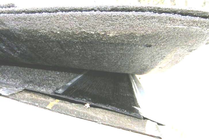

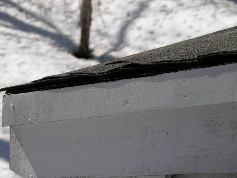

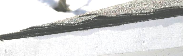

JohnC Posted March 12, 2008 Report Share Posted March 12, 2008 How many layers of shingles does this look like? Unless Iââ¬â¢m losing my eyesight I believe itââ¬â¢s two. The realtor e-mailed me and said the owner stated that the two layers are a grace ice and water shield and one layer of shingles. (8 years old) In addition there is a small sunroof and the shingles are in poor shape with a lot of cracking, these shingles need replacement. The owner said they are also only 8 years old, but regardless they need replacement. I lifted up a couple of edges and did not see much of an ice & water shield. I am enclosing a few photos. Thanks for any input itââ¬â¢s always greatly appreciated. John C Image Insert: 61.27 KB Image Insert: 50.66 KB Image Insert: 174.3 KB Image Insert: 185.72 KB Image Insert: 133.93 KB Image Insert: 71.25 KB Link to comment Share on other sites More sharing options...
kurt Posted March 12, 2008 Report Share Posted March 12, 2008 I'm seeing 2 layers. The last photo looks like 90# felt, not ice & water shield. If it is ice & water shield, it's installed improperly. It should be wrapped down behind the gutter. Link to comment Share on other sites More sharing options...
Brian G Posted March 12, 2008 Report Share Posted March 12, 2008 The first photo definitely looks like two layers of shingles; the last one, not so much. That 4th shot appears to be a cut (?). I have no idea what Grace Ice & Water Shield looks like, but I'm sure someone farther north will. Brian G. No Ice Down Here to Shield [8D] Link to comment Share on other sites More sharing options...
Bill Kibbel Posted March 12, 2008 Report Share Posted March 12, 2008 Pics # 1&2, clearly show 2 layers. Here's a lighter pic 2: The last pic looks like felt, starter, first layer, then a second layer without a starter. Link to comment Share on other sites More sharing options...
Brandon Whitmore Posted March 12, 2008 Report Share Posted March 12, 2008 The first photo definitely looks like two layers of shingles; the last one, not so much. That 4th shot appears to be a cut I agree with Brian. The shingles do not look that old.... I can't tell from the pictures why there are cracks present. Also, the original layer of shingles on the rake edges don't look worn (look newer)- -it's got me stumped. Link to comment Share on other sites More sharing options...
davidlord Posted March 13, 2008 Report Share Posted March 13, 2008 How old is the house? Is it old enough to make two layers a possibility? Take a look in the attic at the nails protruding through the sheathing and that will help determine the number of layers. The key slot is pretty narrow indicating the shingles are not that old. Eight years sounds (and looks) about right. Link to comment Share on other sites More sharing options...
Brandon Chew Posted March 13, 2008 Report Share Posted March 13, 2008 FYI- I've seen some roofs where the roofer applies an extra layer of shingles at the rakes. Could this have been the case here? The tip about counting nails in the attic is a good one and can be used to confirm other observations about number of layers present. Nails are supposed to penetrate at least 3/4" into the roof deck. If the deck is sheathing they should come all the way through. Link to comment Share on other sites More sharing options...

drcr Posted March 19, 2008 Report Share Posted March 19, 2008 From what I can see in the pics. Two layers of shingles. The original shingle overhang was cut back from the edge. The eave pic shows some type of underlayment, probably cheap ice and water shield (although it does look like 45lb felt), and one layer of shingles. My guess is this house has a ventilation problem. Possibly the reason for the new shingles deteriorating. The roofer might have removed about 3 foot of the original eave shingles to install the ice and water. I agree the i&w should be behind the gutter and under the drip edge. Rake edges? That depends on local conditions. When I started installing shingles, looonnnng ago, we gaged the edge by measuring with the index finger. From the tip to the first knuckle crease is 1". The far end was cut with snips and a hatchet with blade and a chalk line. We didn't waste shingles up the rake to use as a gage. That is the basic scenario. There are a lot of variables. If the roof was out of square, you had to chalk vertical lines and measure to the edge. This was the time of 3tabs. If plywood was used for sheathing, and the carpenters ran it over the rake board, drip edge was installed to protect the plywood. Sometimes the rake board was warped or bowed and drip edge would be installed to make it look better. If I were in a high wind location, and still installing shingles, I think the new self stick starter strips would be the way to go on both the eave edges and the rakes. Lots of variables and regional variations. Link to comment Share on other sites More sharing options...
