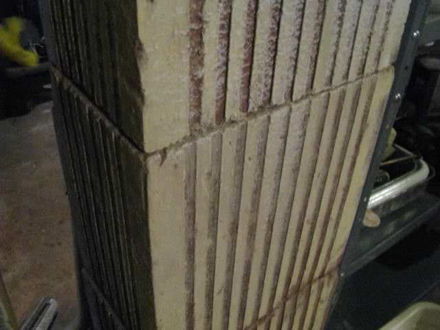

travismoshier Posted October 11, 2008 Report Share Posted October 11, 2008 I found this clay block in a basement today. Does anyone know what this material is called? Image Insert: 75.52 KB Image Insert: 76.61 KB Quote Link to comment Share on other sites More sharing options...
Jerry Simon Posted October 11, 2008 Report Share Posted October 11, 2008 Telephone tile Quote Link to comment Share on other sites More sharing options...
Bill Kibbel Posted October 12, 2008 Report Share Posted October 12, 2008 There's 4 threads on here about that stuff. I get many calls and e-mails about it so I posted this: http://historicbldgs.com/terra_cotta.htm It's often incorrectly identified it as "telephone tile" Here's a pic of telephone/telegraph tile. It was not manufactured as a building material, but rather conduit for underground utility cable installations. Quote Link to comment Share on other sites More sharing options...
aaronm Posted October 15, 2008 Report Share Posted October 15, 2008 They still build new buildings with this material in Eastern Europe. Quote Link to comment Share on other sites More sharing options...
davidlord Posted October 15, 2008 Report Share Posted October 15, 2008 Structural terra cotta is the correct term. I usually just tell folks its hollow clay tile. There are houses in a section of the historic district along the bayfront where the foundations and exterior walls are constructed with clay tile. Late 1800's stuff. Quote Link to comment Share on other sites More sharing options...

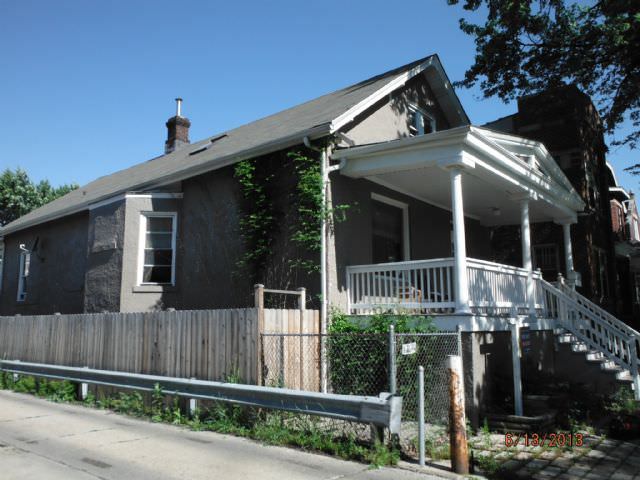

Mike Lamb Posted June 14, 2013 Report Share Posted June 14, 2013 I kept searching phone tile. It took a little while to find the right reference. I'm guessing attaching framing to this could be problematic. This front porch roof is falling off the wall. It's not phone tile, it's STRUCTURAL TERRA COTTA! Click to Enlarge 63.37 KB Click to Enlarge 60.75 KB Click to Enlarge 66.96 KB Click to Enlarge 26 KB Quote Link to comment Share on other sites More sharing options...
