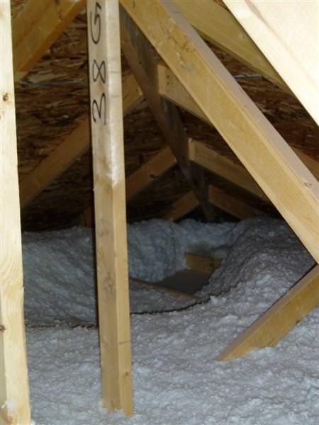

msteger Posted May 28, 2009 Report Share Posted May 28, 2009 At this morning's inspection, I ran across a white cotton-like loose fill or blown in insulation that was put in a few years ago. It isn't itchy like loose fill fiberglass but appears to be a bit lighter-weight and easier to move around. I asked the seller about it since it was installed 2 years back and the paperwork he had just said R-30 loose fill and it was 10" thick, appearing to be R-3 per inch. The paperwork didn't go into specifics about what type of insulation it was. Does anyone know what this stuff really is and what it is called and the actual R-value? I did a Google search for 'cotton insulation' and similar but didn't find what I was looking for. Thanks. Link to comment Share on other sites More sharing options...

Erby Posted May 28, 2009 Report Share Posted May 28, 2009 Where's the picture, Matt?? Link to comment Share on other sites More sharing options...
kurt Posted May 28, 2009 Report Share Posted May 28, 2009 Sounds like a low density fiberglass. Lottsa convection heat loss..... Link to comment Share on other sites More sharing options...
hausdok Posted May 28, 2009 Report Share Posted May 28, 2009 Hi, It's loose fill fiberglass. I see mountains of the stuff on a daily basis. The new formulation is the white stuff and it doesn't itch at all. The yellow and pink stuff? That'll drive ya nuts. ONE TEAM - ONE FIGHT!!! Mike Link to comment Share on other sites More sharing options...

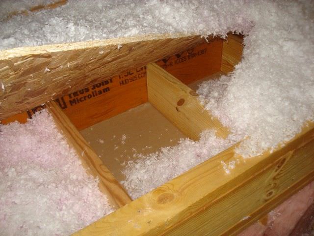

Erby Posted May 28, 2009 Report Share Posted May 28, 2009 Is it this stuff?? Click to Enlarge 53.1 KB Click to Enlarge 60.46 KB Link to comment Share on other sites More sharing options...

msteger Posted May 28, 2009 Author Report Share Posted May 28, 2009 Is it this stuff?? Click to Enlarge 53.1 KB Click to Enlarge 60.46 KB YES, that's the stuff. I guess it really is fiberglass. The insulation contractor finally called me back today and confirmed it. He called it "Insul-Safe". Just wanted to be sure since it didn't feel like fiberglass. Link to comment Share on other sites More sharing options...
