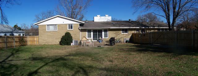

esch Posted December 2, 2009 Report Share Posted December 2, 2009 Just thought I'd share my findings This is the most layers I have found yet. (asphalt) Click to Enlarge 37.01 KB 8 Layers on this 1960 house. How common is it to find this many layers? The house shows NO settlement other then on one wall theres a vertical crack close to corner on brick outside, but unable to be found inside. Its around a 4 pitch roof with 2x6 rafters and 1x6 ridge board. Very sound house. Quote Link to comment Share on other sites More sharing options...
Tom Raymond Posted December 2, 2009 Report Share Posted December 2, 2009 It would be with all that weight holding it down. Typical 3 tabs are about 70 pounds per bundle, that translates to 168 pounds per square foot or 1680 pounds per square. That's more than four times the design snow load here in snow country [:-bigeyes Tom Quote Link to comment Share on other sites More sharing options...
Neal Lewis Posted December 2, 2009 Report Share Posted December 2, 2009 If that house was built in the 1960's, why would there be 8 layers of shingles? Doesn't make sense. Quote Link to comment Share on other sites More sharing options...
Mike Lamb Posted December 2, 2009 Report Share Posted December 2, 2009 If you counted 8 layers at the eave, you are likely looking at 4 roof jobs. That's alot over a 50 year period. I put the third roof cover on my house (1962) in 2004. I'll leave Tom to the math but that's a heavy roof. Quote Link to comment Share on other sites More sharing options...
Jerry Simon Posted December 2, 2009 Report Share Posted December 2, 2009 If that house was built in the 1960's, why would there be 8 layers of shingles? Doesn't make sense. I agree. 20 bucks says there are three layers (each layer *looks* like three layers). Quote Link to comment Share on other sites More sharing options...

esch19 Posted December 3, 2009 Report Share Posted December 3, 2009 There is only 2 shingles on edges, they stripped them over the eves but left the rest I've heard a rule of thumb is every layer is a half life, is this a common theory? Assuming they were 30 year shingles... 1-30 2-15 3-10 4-5 Maybe I some how miscounted and theres 4 layers, but there is about 2 inches of shingles at cut-outs for the turbine vents in the attic. Still yet, I could have sworn there was 8 layers, as odd as it would be, I'll look one day if I get the chance, I know the owner. Matt Quote Link to comment Share on other sites More sharing options...
kurt Posted December 3, 2009 Report Share Posted December 3, 2009 I agree with Mike. I bet it's 4 roof layers; there's probably some starter strips or underlayment applied that's making it look like 8. 8 layers doesn't make any sense at all. Quote Link to comment Share on other sites More sharing options...
