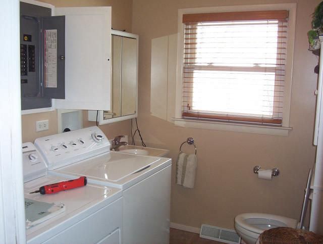

Mike Lamb Posted March 21, 2010 Report Share Posted March 21, 2010 From yesterday. How timely. Click to Enlarge 37.3 KB G2406.2 (303.3) Prohibited locations....surgical rooms. ??? If I ever see a gas appliance in a surgical room, I'm all over it. Quote Link to comment Share on other sites More sharing options...
msteger Posted March 21, 2010 Report Share Posted March 21, 2010 I see dryers (electric and gas) in laundry areas that share space with a half bathroom often. So you are saying that the code doesn't allow laundry areas to share space with bathrooms (should a gas clothes dryer be installed)? Quote Link to comment Share on other sites More sharing options...
Jim Katen Posted March 21, 2010 Report Share Posted March 21, 2010 I see dryers (electric and gas) in laundry areas that share space with a half bathroom often. So you are saying that the code doesn't allow laundry areas to share space with bathrooms (should a gas clothes dryer be installed)? It's not a matter of what I, or anyone else, says. Here's the code section: G2406.2 (303.3) Prohibited locations. Appliances shall not be located in sleeping rooms, bathrooms, toilet rooms, storage closets or surgical rooms, or in a space that opens only into such rooms or spaces, except where the installation complies with one of the following: blah, blah, blah. Gas dryers are considered to be gas appliances. - Jim Katen, Oregon Quote Link to comment Share on other sites More sharing options...
