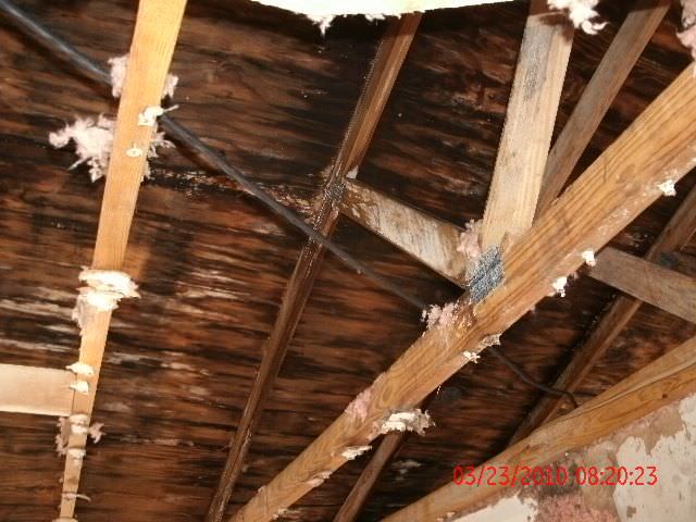

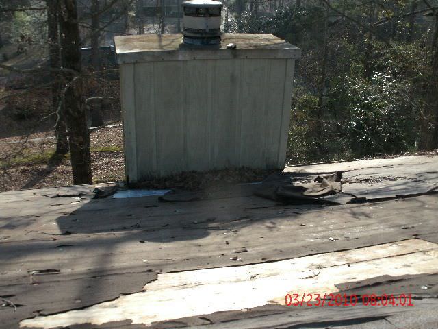

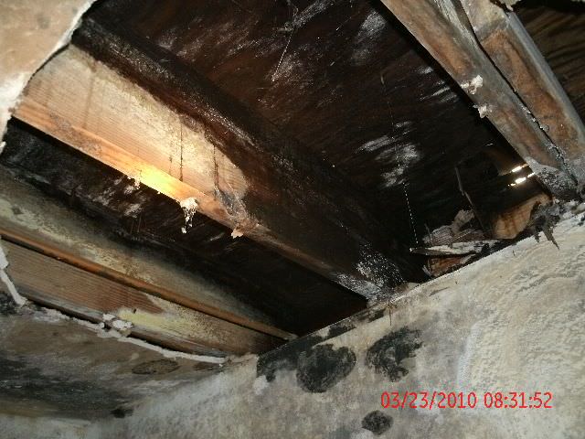

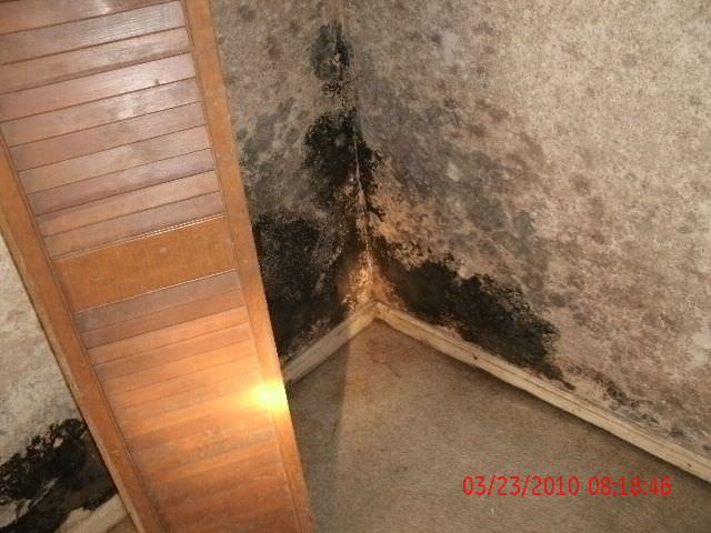

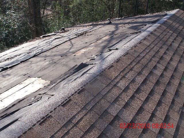

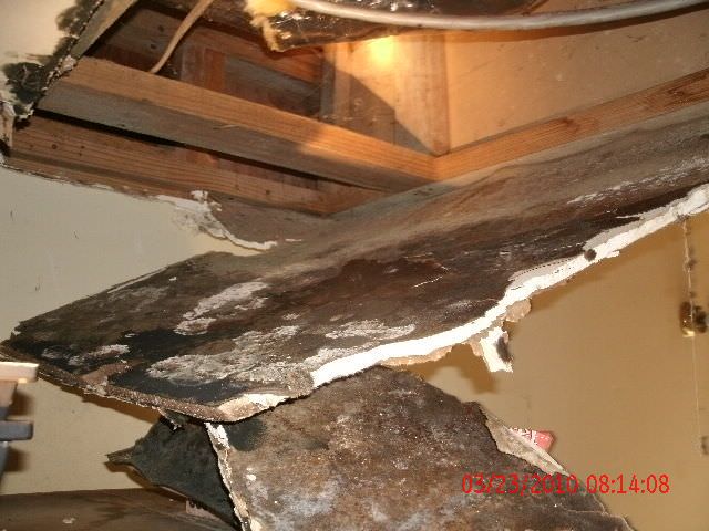

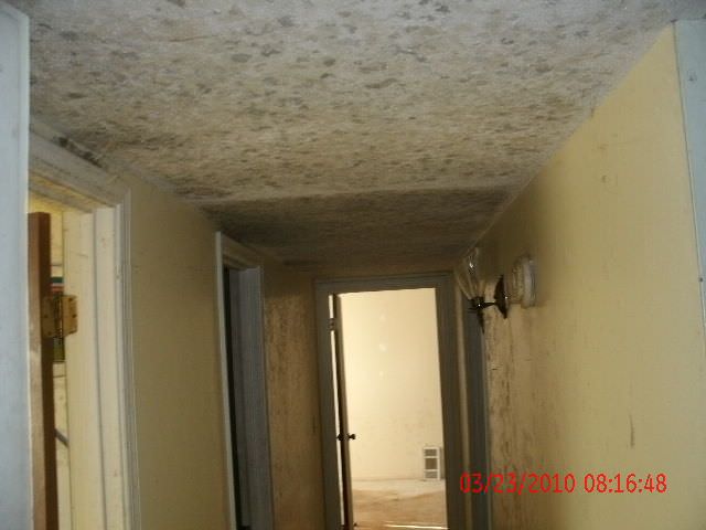

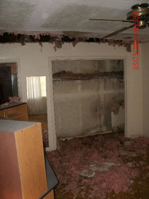

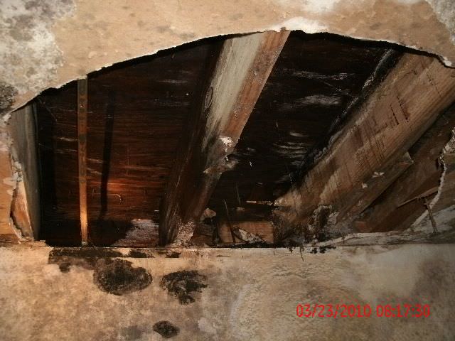

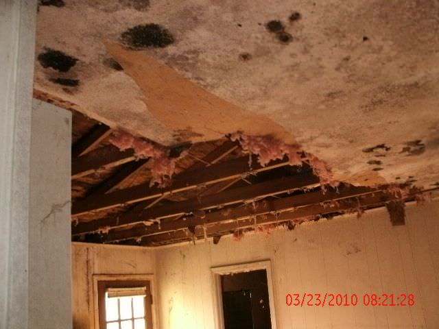

Phillip Posted March 24, 2010 Report Share Posted March 24, 2010 Photos says it all. Click to Enlarge 47.67 KB Click to Enlarge 57.86 KB Click to Enlarge 122.69 KB Click to Enlarge 67.89 KB Click to Enlarge 112.25 KB Click to Enlarge 61.03 KB Click to Enlarge 36.78 KB Click to Enlarge 60.84 KB Click to Enlarge 59.2 KB Click to Enlarge 53.48 KB Click to Enlarge 68.6 KB Click to Enlarge 66.65 KB Click to Enlarge 49.04 KB Quote Link to comment Share on other sites More sharing options...

Stephen D. Gazo Posted March 24, 2010 Report Share Posted March 24, 2010 I hope that when you looked in the house you reached for your respirator, the airborne (huah) particulate in that place must be crazy, it will clog a clean lung in seconds. Gotta match Quote Link to comment Share on other sites More sharing options...

Tom Raymond Posted March 24, 2010 Report Share Posted March 24, 2010 It's not that bad. You should be able to fix everything there with a four hour dozer rental. I was particularly amuzed by pic #5, a shiny dish on a felt paper roof cover. Priorities. Tom Quote Link to comment Share on other sites More sharing options...
hausdok Posted March 24, 2010 Report Share Posted March 24, 2010 I think that one would be pretty simple to write up and explain to the client. You essentially tell them that what they are purchasing is the frame of a house that's had the wiring and the plumbing roughed in and will need significant repair. They'll need to strip out 100% of the drywall and the insulation, strip the decks off the roof and floors, strip off the siding, replace the rotting components in the frame, treat 100 of the framing with a penetrating fungicide and then proceed as if they were in the early stages of construction of a new home and hope they don't run out of time or money like the last guy did before they get it done. I can't imagine a bank being willing to finance an attempt at fixing that mess. ONE TEAM - ONE FIGHT!!! Mike Quote Link to comment Share on other sites More sharing options...

Phillip Posted March 24, 2010 Author Report Share Posted March 24, 2010 The buyer is an investor that if they get it, is going to do a flip. The power was off so was the water and gas. I was only there an hour, Taking photos I wrote along the lines as Mike talked about. Tear out everything replace on the rot and treat. Yes i did wear my respirator, the dish is mounted on the fascia trim. I had to sign paperwork that say I would hold the bank and agent harmless before I could go into the place. Quote Link to comment Share on other sites More sharing options...

Phillip Posted March 25, 2010 Author Report Share Posted March 25, 2010 Jobs like that, it's pretty self evident what needs to be done. Unfortunately, with whatever standards you are under, reporting is not as easy as others would lead you to believe. There is extreme CYA in homes like this, these people may be looking for someone else to foot the bill for "repairs". It took me two hours to write the report. The state of Alabama uses the 2000 ASHI standards. Quote Link to comment Share on other sites More sharing options...

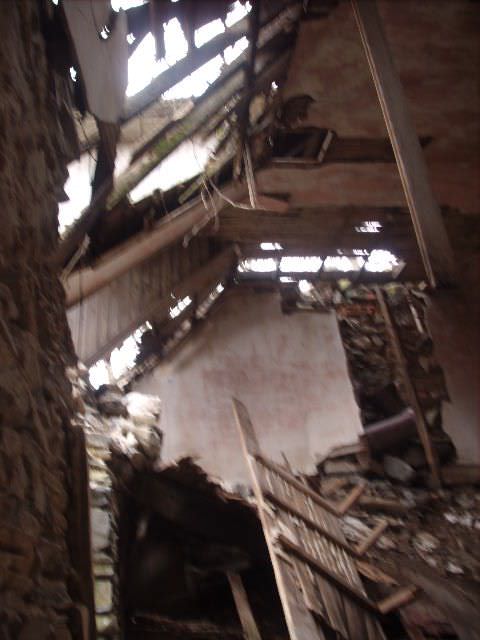

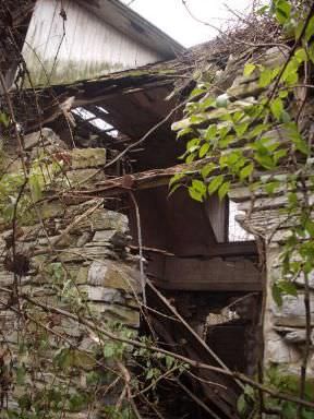

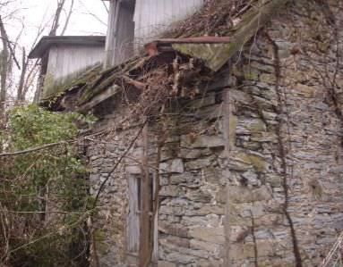

Bill Kibbel Posted March 26, 2010 Report Share Posted March 26, 2010 I've been hired to inspect many buildings that were completely uninhabitable and some that were unsafe to even stand near. I don't walk away - some folks really want to know if a building is salvageable and what steps to take to stabilize and eventually restore it. One of my favorites: Click to Enlarge 79.65 KB Click to Enlarge 32.29 KB Click to Enlarge 33.88 KB Click to Enlarge 45.33 KB Click to Enlarge 49.62 KB Quote Link to comment Share on other sites More sharing options...
kurt Posted March 26, 2010 Report Share Posted March 26, 2010 How old was that beauty? Quote Link to comment Share on other sites More sharing options...
Mark P Posted March 26, 2010 Report Share Posted March 26, 2010 Yes that house is beautiful in its own way, but I could never inspect it. I would have no idea what to say. Quote Link to comment Share on other sites More sharing options...
Terence McCann Posted March 26, 2010 Report Share Posted March 26, 2010 I've been hired to inspect many buildings that were completely uninhabitable and some that were unsafe to even stand near. I don't walk away - some folks really want to know if a building is salvageable and what steps to take to stabilize and eventually restore it. With your reputation Bill I would imagine that folks hire you to inspect an old structure that the folks want to rehab (like a This Old House gig) and/or may have some historical significance - that's one thing. To go into a bad neighborhood so that you can inspect a burned out 800 sf crack house, or one like Phillips, just waiting for your special touch classic, is quite another. Here's a stick of dynamite and a match. That'll be 1020.00 - 20.00 for the stick of dynamite and 1000.00 for knowing where to get it. [] Quote Link to comment Share on other sites More sharing options...
