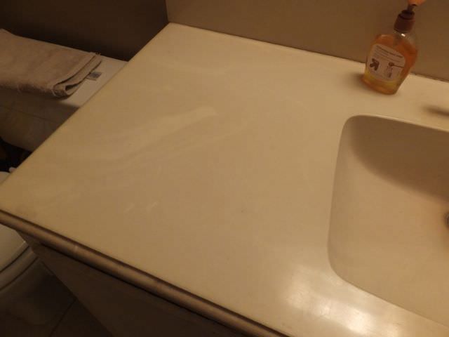

Marc Posted May 3, 2014 Report Share Posted May 3, 2014 You mean like this? Click to Enlarge 19.01 KB Marc Quote Link to comment Share on other sites More sharing options...

Jim Katen Posted May 3, 2014 Author Report Share Posted May 3, 2014 You mean like this? Click to Enlarge 19.01 KB Marc Sort of. The stuff in your picture looks like a solid surface material. The thing I'm thinking of is all cast in a single piece, including the backsplash and it's never quite as subdued as the one in your picture. It also has a tendency to develop cracking around the drain flange. Quote Link to comment Share on other sites More sharing options...

Marc Posted May 3, 2014 Report Share Posted May 3, 2014 The coloring goes only about an eighth of an inch deep. The substrate is translucent. CT and lav are one piece. Both our baths use the same material for surrounds and lav/CT. Common in the late 70's, early 80's around here. Marc Quote Link to comment Share on other sites More sharing options...

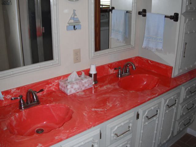

hoosier inspector Posted May 6, 2014 Report Share Posted May 6, 2014 I remember a wacked out blue and pink one a couple years ago. This one is from last year. Click to Enlarge 42.12 KB Quote Link to comment Share on other sites More sharing options...
palmettoinspect Posted May 6, 2014 Report Share Posted May 6, 2014 I remember a wacked out blue and pink one a couple years ago. This one is from last year. Click to Enlarge 42.12 KB Ahhh! The clam shell design! Always called the stuff cultured marble. Quote Link to comment Share on other sites More sharing options...
Jim Katen Posted May 6, 2014 Author Report Share Posted May 6, 2014 I remember a wacked out blue and pink one a couple years ago. This one is from last year. Click to Enlarge 42.12 KB Oh, that's a good one. Quote Link to comment Share on other sites More sharing options...
Chad Fabry Posted May 6, 2014 Report Share Posted May 6, 2014 I remember a wacked out blue and pink one a couple years ago. This one is from last year. Click to Enlarge 42.12 KB Oh, that's a good one. Wow. Somebody liked it enough to install newer faucets. Quote Link to comment Share on other sites More sharing options...
