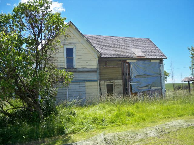

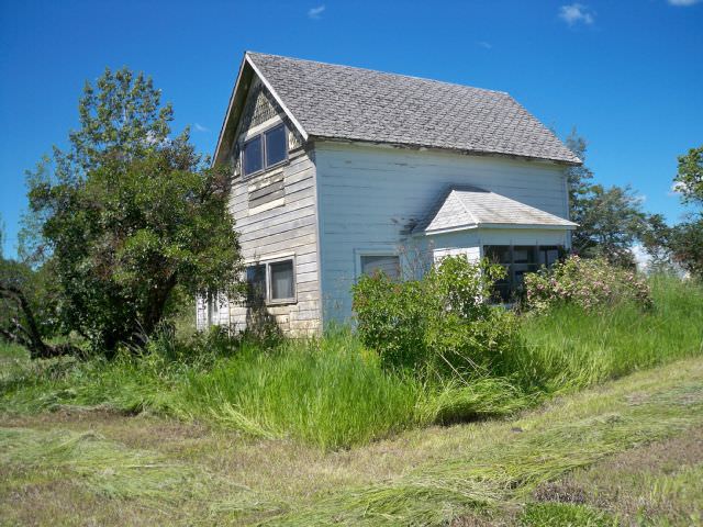

BobL Posted July 7, 2010 Report Share Posted July 7, 2010 Yes, that's correct. $3,500 for a house! With an acre of land. It's being described as a turn of the century farm house fixer upper. Haven't had a chance to see the inside yet. It is definitely in rough condition, however we could get into a place with no debt if we decide to buy this place. We're thinking that we would need to move a travel trailer or 5th wheel type camper on site to live in until we get this place habitable. There's a lot going on with this property. Anything jump out at you professionals that I might miss? Anything I should look for when I gain access to the inside? Having a professional inspector look at the place is in the works. He's doing it as a favor and it's a 2 hour drive to the property so he'll come after we look at the inside. I didn't include pictures of the barn, it's beyond saving as a structure. However some neat wood beams lurk in there... Click to Enlarge 83.02 KB Click to Enlarge 74.68 KB Click to Enlarge 82.79 KB Quote Link to comment Share on other sites More sharing options...
hausdok Posted July 7, 2010 Report Share Posted July 7, 2010 Whew! Hope you've got some serious skills. It needs a roof. That aluminum window probably wasn't flashed correction when it was put in, which means that gable end wall will probably have mold in it, and I don't even want to think about what's behind that tarp. Still, they can be made habitable. My Dad bought one in similar condition when I was about 7 years old. He spent a couple of months of his spare time installing wiring and plumbing, a water heater, furnace and bathrooms - it didn't have any of that - and moved us into it and worked on it part-time for the next 17 years the family lived there. My Dad was a custom builder. It's funny, he'd build these beautiful homes for folks but never really got around to finishing that house until he'd bought another one at another tax sale - one in worse condition - and was preparing to move what remained of the family into it and start the process all over again. ONE TEAM - ONE FIGHT!!! Mike Quote Link to comment Share on other sites More sharing options...
BobL Posted July 7, 2010 Author Report Share Posted July 7, 2010 Under the tarp is plywood. Quote Link to comment Share on other sites More sharing options...

Marc Posted July 7, 2010 Report Share Posted July 7, 2010 If I ignore the exterior finishes, fenestration openings and landscaping, I see but straight lines. Ridge, elevations, roof lines, all straight. That speaks well of the framing. It could be an ugly duckling. Repair the finishes, inside and out, maybe windows and doors, and it may end up able to serve another century. I wouldn't be surprised if it did. Just my opinion. Marc Quote Link to comment Share on other sites More sharing options...
BobL Posted July 7, 2010 Author Report Share Posted July 7, 2010 Marc, that's exactly what I thought when I looked at the house. It is remarkably straight. Quote Link to comment Share on other sites More sharing options...

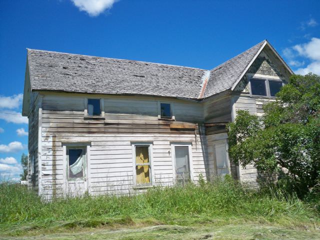

John Kogel Posted July 7, 2010 Report Share Posted July 7, 2010 I hope the inspector checks that roof edge in the second picture, pokes a screwdriver into the rafter ends and where they connect with the sill. Checks the foundations all around. Looking for termites and rot. It may not have much insulation, probably had none when built. The plumbing and electrical all needs replacing, I can see that from here. [] Is there a well? Where's the pump? What about the septic tank? [] Quote Link to comment Share on other sites More sharing options...
kurt Posted July 7, 2010 Report Share Posted July 7, 2010 It's old growth Idaho timber; that by itself would make me think the frame is salvagable. Quote Link to comment Share on other sites More sharing options...
David Meiland Posted July 7, 2010 Report Share Posted July 7, 2010 $3500?? My house looked somewhat like that, maybe a little better... and I paid $200,000. You might find that it needs a foundation and a roof, all new doors, windows, and siding, and a complete gut remodel inside. Old farmhouses often sit on some pretty good land. Quote Link to comment Share on other sites More sharing options...
inspector57 Posted July 7, 2010 Report Share Posted July 7, 2010 Around here just the land would be worth more than $3500 and the house and barn have more value in the salvaged wood. Like others said, the basic structure looks pretty straight and you can see everything else has to be redone. The only things I can think of that might bite you is any old environmental concerns like underground storage tanks, toxic stuff or lack of access to utilities. I'd buy it in a heartbeat. Quote Link to comment Share on other sites More sharing options...
