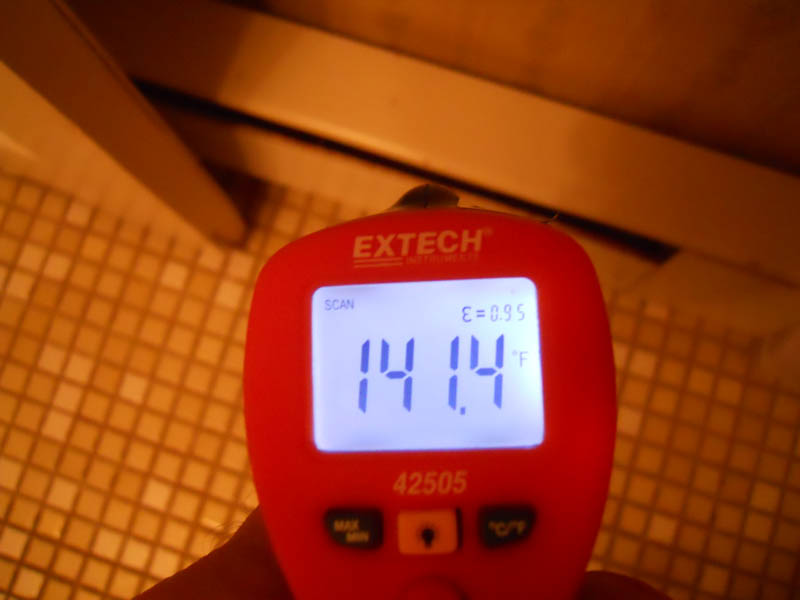

rbaake Posted October 30, 2011 Author Report Share Posted October 30, 2011 Yes, everything working as intended. I always make certain I have several photos of the units (example from todays inspection included below). I think I learned to take these photos from a post on this forum several years ago and consider them priceless when someone calls six months after their inspection and says the heat isn't working. I always include one for the heating and one for AC in all reports. Download Attachment: JouHeat.jpg 58.63 KB Quote Link to comment Share on other sites More sharing options...
Marc Posted October 30, 2011 Report Share Posted October 30, 2011 Yes, everything working as intended. I always make certain I have several photos of the units (example from todays inspection included below). I always include one for the heating and one for AC in all reports. Download Attachment: JouHeat.jpg 58.63?KB Good idea! Think I'll begin doing that. Marc Quote Link to comment Share on other sites More sharing options...

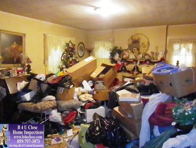

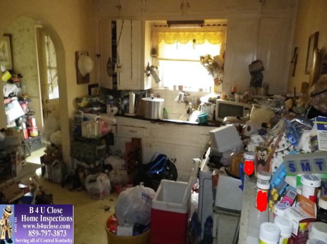

John Kogel Posted October 31, 2011 Report Share Posted October 31, 2011 Speaking of pee on a heater, sometimes, I just turn up the thermostat and wait for my olfactory detector to pick up the scent of cooking hair and sweat socks. "Yep, there's a working baseboard heater behind the bed". [] I save pics of the junk, too, just in case someone thinks I must have been blind to miss that vomit stain on the wall. On Thursday, I pushed some stuff from the washer to the dryer so I could have a clear workspace. If they have a porch, I set up out there sometimes on my step ladder/desk. Animals. Click to Enlarge 59.75?KB Click to Enlarge 50.55?KB Click to Enlarge 42.9 KB Quote Link to comment Share on other sites More sharing options...
