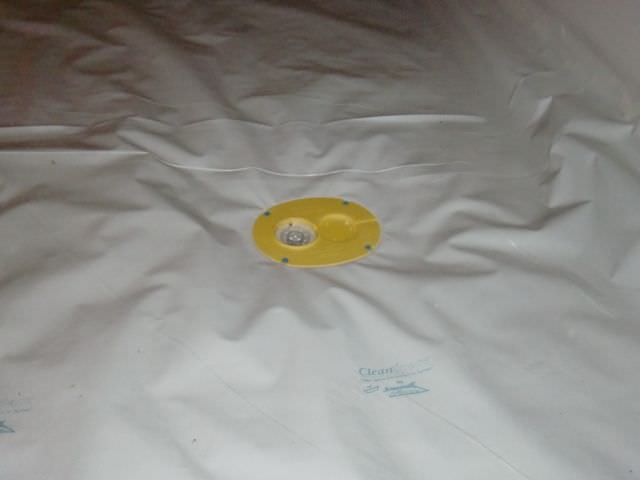

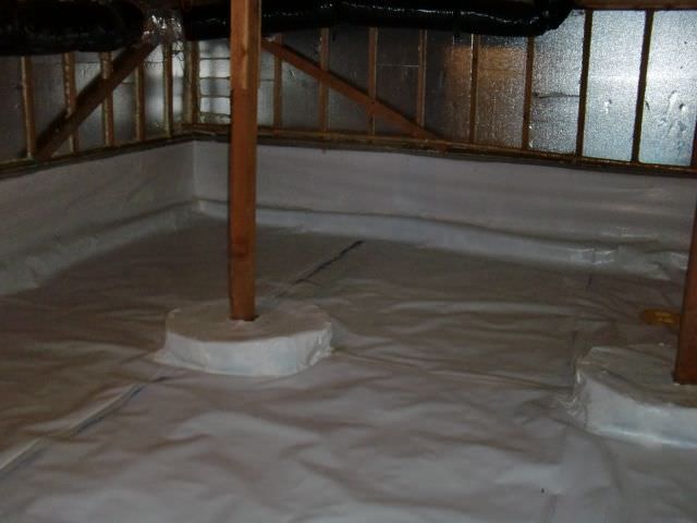

randynavarro Posted May 7, 2010 Report Share Posted May 7, 2010 Had my first one of these today. Click to Enlarge 36.42 KB Click to Enlarge 43.95 KB Click to Enlarge 42.3 KB Click to Enlarge 49.71 KB Quote Link to comment Share on other sites More sharing options...

Mike Lamb Posted May 7, 2010 Report Share Posted May 7, 2010 Wow. Is that furnace set on top of the liner? Do you know the history here, Randy? I'm guessing that liner is on top of gravel or dirt? I've only seen this once also but it was a small 1/2 crawl. Permaseal did it. Very tight work. I'm wondering how much cheaper the zero-perm liner is than concrete. Quote Link to comment Share on other sites More sharing options...

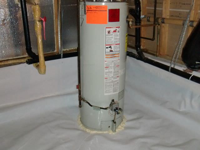

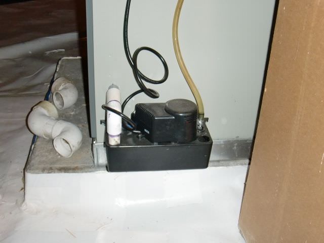

randynavarro Posted May 7, 2010 Author Report Share Posted May 7, 2010 Wow. Is that furnace set on top of the liner? Do you know the history here, Randy? I'm guessing that liner is on top of gravel or dirt? I've only seen this once also but it was a small 1/2 crawl. Permaseal did it. Very tight work. I'm wondering how much cheaper the zero-perm liner is than concrete. The furnace was set on top of a pre-cast fiberglass base and the liner was sealed to that base. Click to Enlarge 32.57 KB The water heater was sitting on top of spray foam--I guess it was just as cheap to do that rather than buy a piece of 2" EPS. Click to Enlarge 39.94 KB I can only guess at the history--lots of rats and water. In fact, there was some sort of proprieatry sump/drainage system involved with the system. Click to Enlarge 22.18 KB Quote Link to comment Share on other sites More sharing options...
Marc Posted May 7, 2010 Report Share Posted May 7, 2010 I guess that it's ok to wash it down every couple years since there's a drain installed. Shouldn't the water heater be elevated a little higher? Marc Quote Link to comment Share on other sites More sharing options...

Hearthman Posted August 14, 2010 Report Share Posted August 14, 2010 The WH should not be foamed into anything but free for service and inspection. In the case with a gas WH, air must be able to flow in from underneath for combustion and cooling. You don't want combustibles at the foot of a gas WH-ever seen the flames flare out when the burners first light or if there is a venting problem? With this space now as tight as Tupperware, where is the requisite makeup air? Quote Link to comment Share on other sites More sharing options...
hausdok Posted August 14, 2010 Report Share Posted August 14, 2010 The WH should not be foamed into anything but free for service and inspection. In the case with a gas WH, air must be able to flow in from underneath for combustion and cooling. You don't want combustibles at the foot of a gas WH-ever seen the flames flare out when the burners first light or if there is a venting problem? With this space now as tight as Tupperware, where is the requisite makeup air? Take another look at that water heater. It's a direct vent water heater and the burner area is completely sealed away from the atmosphere of the crawlspace. It gets it's combustion air via a combi vent that goes through the cripple wall of the foundation. ONE TEAM - ONE FIGHT!!! Mike Quote Link to comment Share on other sites More sharing options...
Hearthman Posted August 14, 2010 Report Share Posted August 14, 2010 Mike, which pic are you looking at? I see the DV furnace but the WH I'm looking at appears to be a standing pilot with a draft hood although the pic is cut off right at the top of the unit. Does the OP have any better pics of the top of the WH? If it is a true DV, then it is not a problem with MUA but you would still need to cross-check for clearances at the base. Quote Link to comment Share on other sites More sharing options...
hausdok Posted August 14, 2010 Report Share Posted August 14, 2010 Look at the water heater again; it's a State brand direct vent unit. See the cover with the window in it? It has a thick foam rubber gasket that seals that cover to the side of the unit and sandwiches the gas and thermocouple lines where they go into the burner pan area at the bottom. ONE TEAM - ONE FIGHT!!! Mike Quote Link to comment Share on other sites More sharing options...

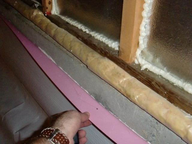

Erby Posted August 16, 2010 Report Share Posted August 16, 2010 Nicely done sealed crawl spaces usually leave a small "termite strip" where you can see the tubes crossing the concrete, don't they? Isn't that what picture #2 in the OP shows. - Quote Link to comment Share on other sites More sharing options...
hausdok Posted August 16, 2010 Report Share Posted August 16, 2010 Nicely done sealed crawl spaces usually leave a small "termite strip" where you can see the tubes crossing the concrete, don't they? Isn't that what picture #2 in the OP shows. Looks like it; except, around here, subs wouldn't be an issue unless that house is in West Seattle. Don't ask me why - haven't a clue; I think it's got something to do with the lack of sub-ter exit visas or something. Around here, one has to keep an eye out for carpenter ants, dampwood termites and deathwatch beetles - none of which constructs mud tubes. I think they've got lots of subs down Robert's way though. ONE TEAM - ONE FIGHT!!! Mike Quote Link to comment Share on other sites More sharing options...
